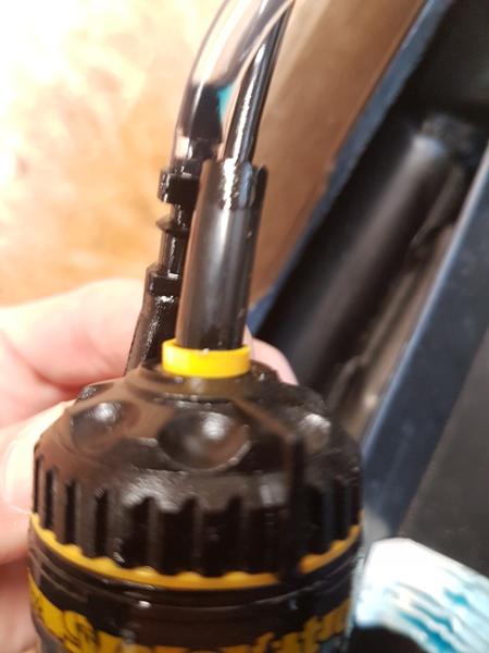

    Her er lidt billeder.
    Her den oprindelige placering og den første beholder, udskiftet i 2014 eller 2015 med en ny (samme placering).

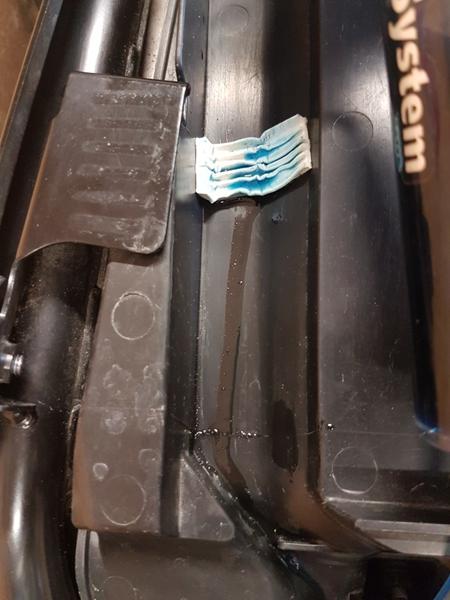

  • #8   15. sep 2019 Da en ny beholder på samme placering ikke ændrede noget, har jeg i foråret taget den "nye" beholder og flyttet op under sædet.
    Den er stadig utæt.
  • #9   15. sep 2019 Utæthed ses her - ren olie på den "pakning" jeg har klistret under sædet, for at få lidt mere hældning på beholderen.
  • #10   15. sep 2019 Snask....

  • #12   15. sep 2019 Scottoliers forklaring:
    Your RMV is lying too near horizontal, with the breather pointing backwards. What is happening is that, when you accelerate hard, the oil (when it’s as in the photos – very near full), sloshes into the breather and down onto the frame.
    Repositioning the RMV, so that it (or the filler plug breather) are facing the opposite direction to avoid this, - or having the reservoir in a more vertical position are the only ways to avoid this.
