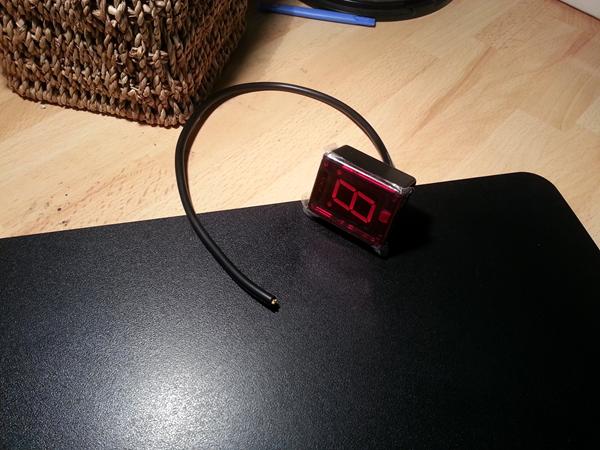

Der fulgte sådan en gear indikator med da jeg købte cyklen.
Er den nem at installere selv, eller kræver det en mere erfaring.
Her er lige et billede

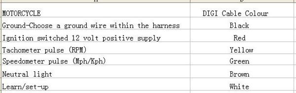

Gear indicators instructions:
The Gear Indicator is suitable for use on the majority of motorcycles equipped with an electronic speedometer and rev counter.
Once wired in it's compact size is unobtrusive in the cockpit, while it's large display provides a highly visible indication of the gear in use, suitable for up to 8 gear ratios it stops you looking for the gear that isn't there (Perfect for race and road use).
Installation is simple and quick, with a programming mode to teach it the relationships of your speedometer and rev counter. The DiGi also comes with auto dim for night-time use, preventing 'Glare' in poor light conditions.
Please note: This does not work on Ducati 749/999 2004.
Display backlight, the surface of the red light to red shirt, gear indicator with internal thephotosensitive system can convert the brightness of the lights, and moving the knight can maintain a goodvisual.
