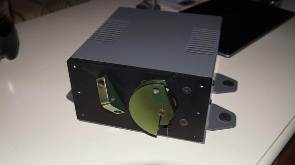

    Det nye setup jeg er ved at få lavet indholde ca:
    Now it has 6/8 analog 0-5V and 8 thermocouples, 12 bit, 50 samples per second.
    And 2 x Load cell channels (16/24 bit)
    But it needs more connectivity. It is envisaged to have CAN communications, 1 bus now, and 2 buses in a future version.
    And also Sportdyno is expanding connectivity (bypassing SP5):
    *Wheather Station
    *OBDII
    *maybe some RS485 or RS422 buses
    For digital input channels:
    *2 x roller channel (pulses)
    *1 x engine rpm channel
    *1 x digital counter (low speed)
    *1 x "PANIC" button
    For outputs:
    2 x brake output (PWM 0 to 5 volt)
    1 x servo (RC pulse or PWM, it can be changed)
    1 x air speed (PWM)
    I think the maximum number of PWMs is 4, but current box does not allow so many connectors
    and for ON/OFF signals
    8 x Relays
    In total there are
    21 x analog IN
    4 x pulse IN
    1 x ON/OFF input
    4 x PWM out
    8 x Relays out
    Total: 38 channels
    Connectivity:
    *1 x RS232 (PC)
    *1 x Ethernet
    *1 x CAN BUS (2 in future),
    *several internal COMs for Bluetooth, remote control, etc
    Selv om jeg har, adgang til alt det her. Så har jeg stadig svært, ved at finde brugbare. Forbedringer i moderne luftfilterkasser, så har nok min tvivl til, ret mange hjemmetunere. Kan gøre det ret meget bedre, end fabrikrene.

    Hvis der skulle være nogen tvivl, så er det en PC styret servo. Der kan læse data fra AIM og 2D datalogger.
